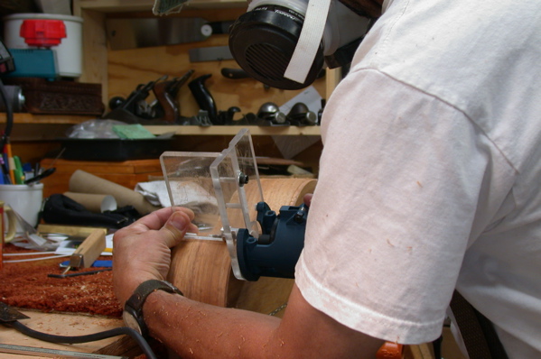

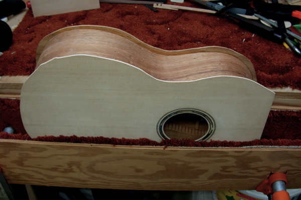

Hesh, I've done some handheld cutting of channels and do not use a holder when doing it. Just a carpet on top of my bench. That W/F setup really looks great though. Everyone raves about it who've tried other methods.

Hesh is right, the guitar really needs to be supported well for the luthiertool jig. It's easy enough, though, to clamp one side of the guitar and rout the other, then turn it around and clamp on the other side.

I use a jig modelled after Arnt's (with two bearings) with a vise of sorts from Sylvan Wells' web site. In case anyone's wondering, the plates were routed flush before routing the rabbets for the binding.
